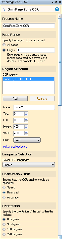

  1. In the Session Configuration Pane, select the stage of processing where you want to use OmniPage Zone OCR.
  2. In the Tasks Pane, select OmniPage Zone OCR.
  3. You can optionally enter a name for the process under Process Name.
  4. Move through each step of the wizard at the bottom of the pane. You can also click Skip Wizard to display and configure the properties all at once.
  5. Page Range: When configuring a process in Page Processing or Post-Processing, you will be prompted to specify a page range. In other stages, default settings will be automatically applied.
    Note: When Zone OCR is configured to extract information from a zone on multiple pages, it only retains the value of the zone on the last page processed. If you want to accumulate all the values, use the Token Accumulator process.
  6. Region Selection: Define one or more regions, or zones, to be read by the OmniPage Zone OCR process.
    • To define a region, drag and resize the zone on the Display Pane or specify coordinates in pixels or by percentage in the Tasks Pane.
      Tip: If you are zoomed in to a specific area of an image, adding a zone will place it in the top left corner of the zoomed in image for convenience.
    • Specify a name for the region. This will also be the name of the token that represents the value read from the region.
    • To define an additional region with the same settings, click Add again.
    • To remove a region, select it and click Remove.
    • To configure advanced OCR options for a specific region, select the region and click Advanced options. More info.
    Note: Zones can be copied and pasted within this and other processes that contain zones. When copying a zone within this process, pasting using CTRL + V will paste the zone directly on top of the zone you copied. Right-clicking on a different area of the image and selecting Paste Zone from the context menu will paste the copied zone where you right-clicked. The advanced settings will be copied as well.

  10. Orientation: Specify the zone's orientation. If a captured document's text in the zone matches this setting, OCR will be more accurate.
    Tip: 0 degrees represents a standard page with text that reads from left to right. 180 degrees represents a page that appears upside down.
