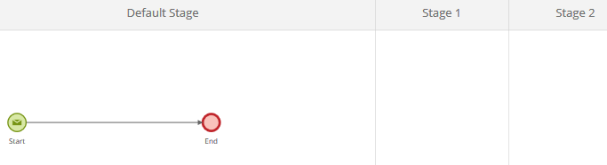

Stages
Default stage in a process diagram
The process diagram also contains stages, which are regions of the diagram separated by vertical lines. For example, in the screenshot above, the depicted process is located entirely within the Default Stage, with Stages 1 and 2 being blank. Stages can be used to visually organize a complicated process. Stages do not affect how processes actually run—you can put any process entirely in one stage, or spread it over several stages, without changing how it runs.

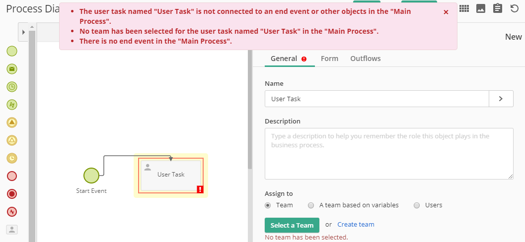

  9. When you are done, click the Validate button (Validate button) in the top right corner to check for validation errors in your process. Validation errors are displayed on the process in the following places:
    • At the top of the process designer page, together with details about the error.
    • On the process objects that contribute to the error.
    • On the tab title in the right pane, if the pane is opened to an object that contributes to the error.
    • In the section that is not configured in the right pane, along with details about the error.
    • In the minimap (if the minimap is displayed).
    Validation errors in the process designer
