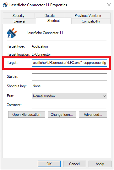

Q: How can I have the Laserfiche Connector Configuration dialog box not appear when users launch Laserfiche Connector?
Laserfiche Connector will not automatically open the Configuration dialog box when the application is launched on machine startup. You can also disable the Configuration dialog box from appearing when users manually start Laserfiche Connector.
To have Laserfiche Connector show up in the taskbar without opening the Configuration dialog box, add the parameter "-suppressconfig" to the Laserfiche Connector's shortcut's target. You must update each shortcut that you don't want the Configuration dialog box to automatically open from.
To update the target
  1. Right-click the shortcut.
  2. Select Properties.
  3. Open the Shortcut tab.
  4. Add " - suppressconfig" to the end of the Target field.
  5. The target is updated in the Shortcut's tab of the Properties dialog box.
